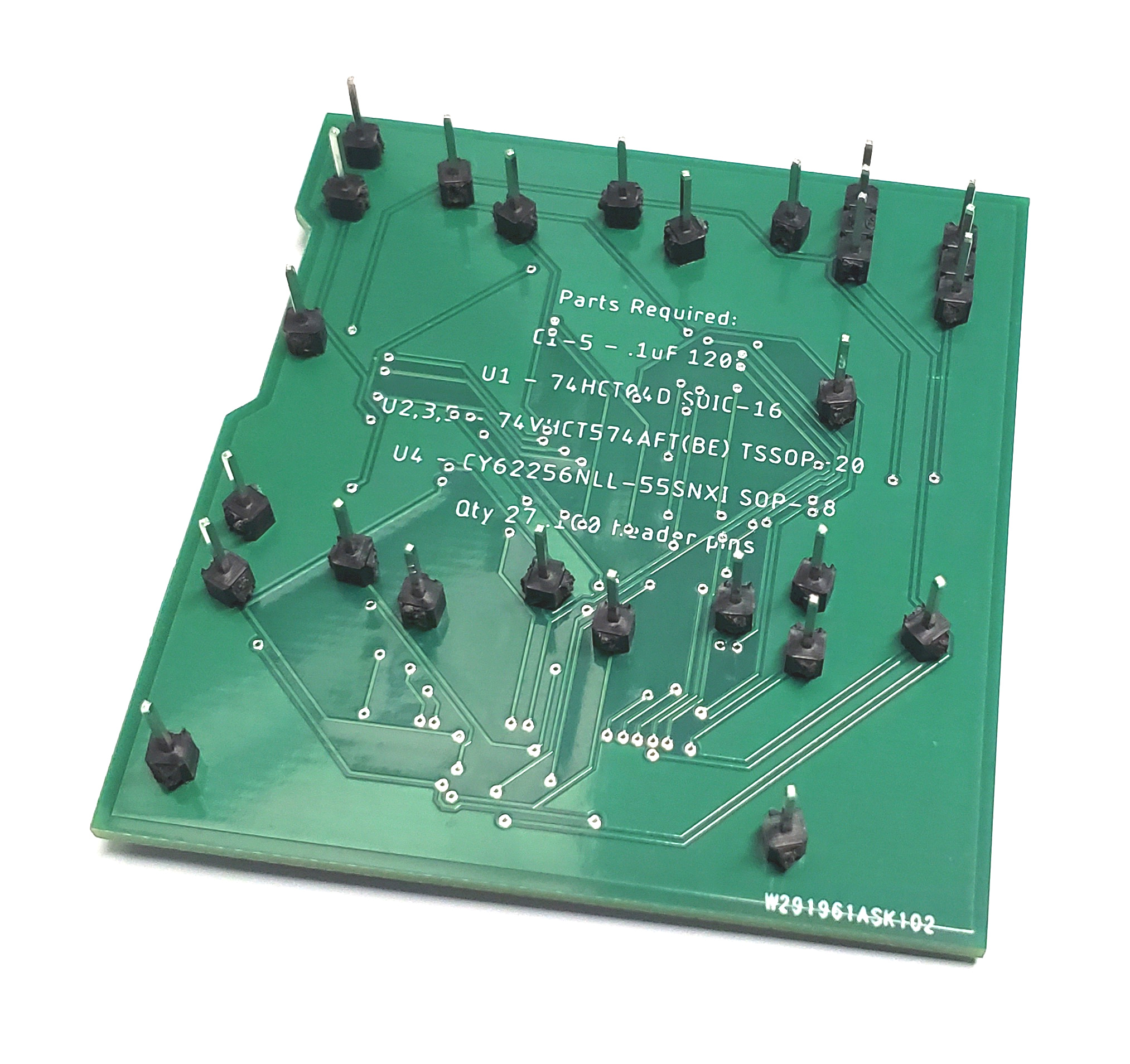

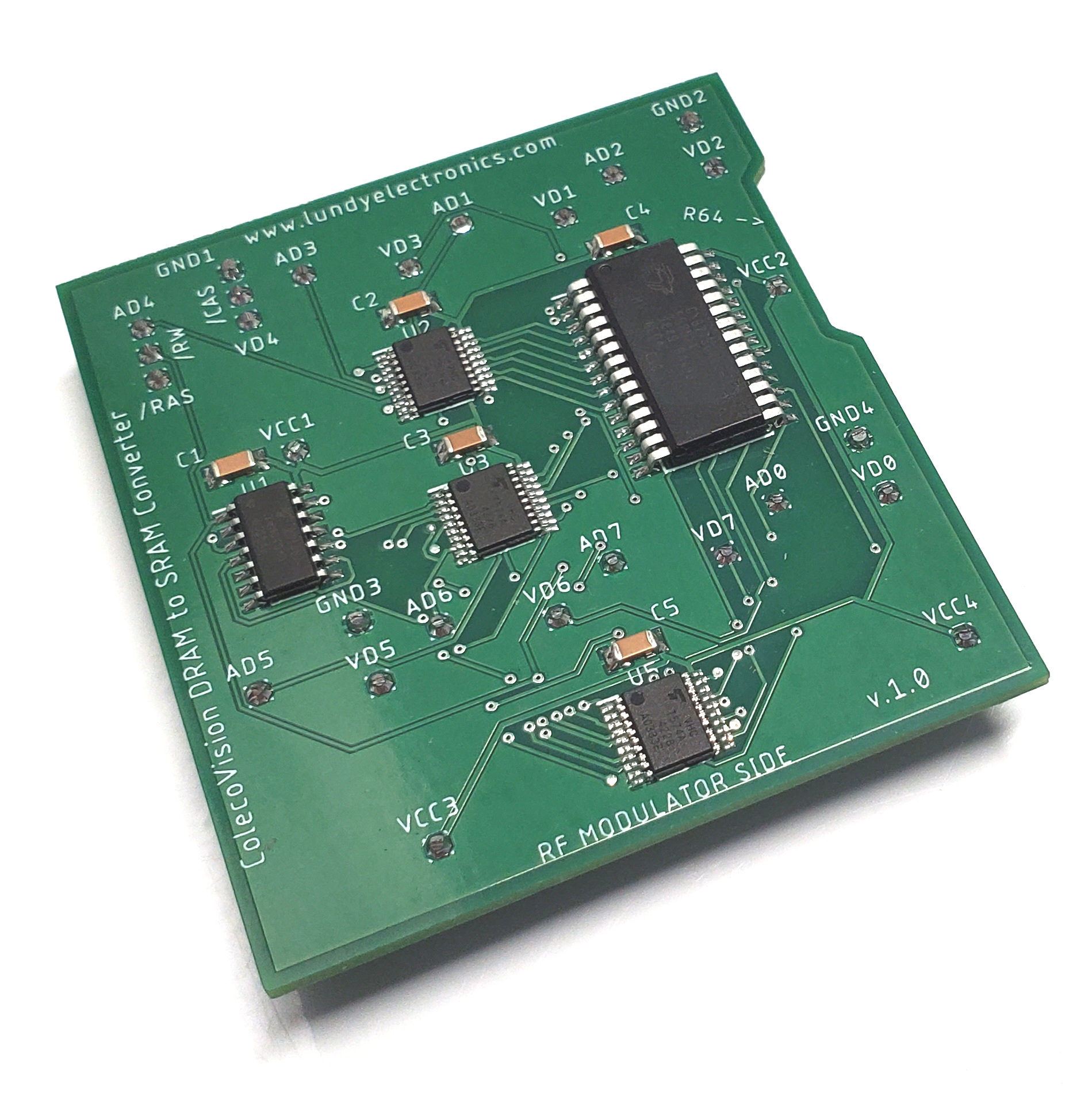

A board that replaces the ColecoVision's video memory with modern static RAM - one of the most worthwhile things that can be done to a console that is still working, and the fix for one that is not.
The problem
  • The console uses eight 4116 DRAM chips, which need three supply rails: +5V, +12V and -5V.
  • They run hot and fail, and the console's power switch is unreliable in a way that makes that worse - dirty contacts show up as glitched graphics or no picture at all.
What the board does
  • The original DRAM, its decoupling capacitors and the power inductors all come out, and the converter goes where the DRAM was.
  • Modern SRAM needs 5V alone, so the +12V and -5V rails stop being needed for memory at all - less heat, fewer parts, and one less thing the ageing supply has to deliver.
