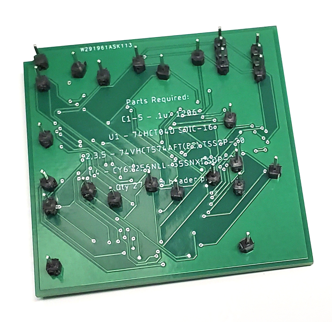

The Lundy Electronics ColecoVision PAL DRAM to SRAM Converter PCB mod uses modern, readily available components to replace original, obsolete DRAM. The added benefit of this mod is that it also removes the inefficient need of +12v and -5v required by the original DRAM. All the original DRAM, associated decoupling capacitors, and power inductors are completely removed from the system. The new SRAM Conversion PCB then installs where the original DRAM was located, and specific required pins are then soldered in place on the PCB. The Converter PCB only requires 27 total solder pins verses the original 156 total DRAM, associated decoupling capacitors, and inductor solder joints and is designed to be soldered directly to the ColecoVision PCB without using any sockets. Limit three per customer.
