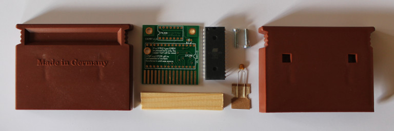

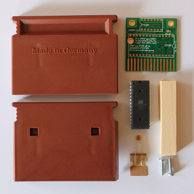

Each Homebrew Kit contained enough components to construct two cartridges.
For each cartridge the kit supplied:
  • Cartridge case
  • Screw

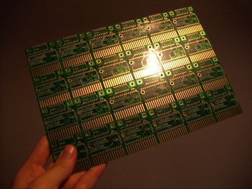

  • Printed circuit board
  • 32 KB CMOS EPROM
  • 0.1 µF capacitor
  • Logic chip
The cartridge cases were available in either black or red, depending upon the version of the kit. The printed circuit boards featured a gold surface finish.
