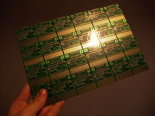

The cartridge cases were available in either black or red, depending upon the version of the kit. The printed circuit boards featured a gold surface finish.

After programming the EPROM, the electronic components were installed and soldered to the supplied printed circuit board. The completed board was then installed inside the cartridge shell to produce a conventional physical ColecoVision cartridge.
