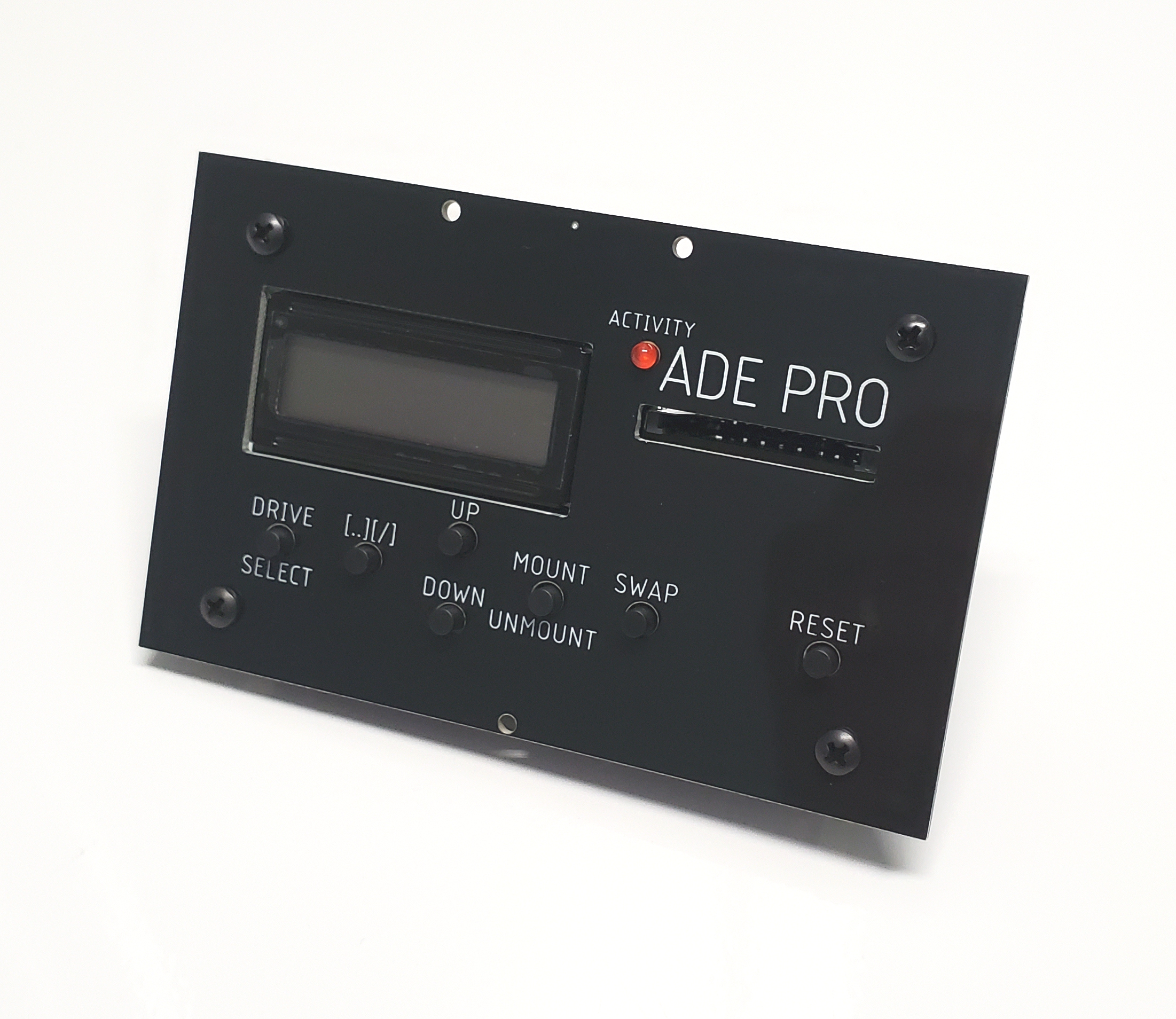

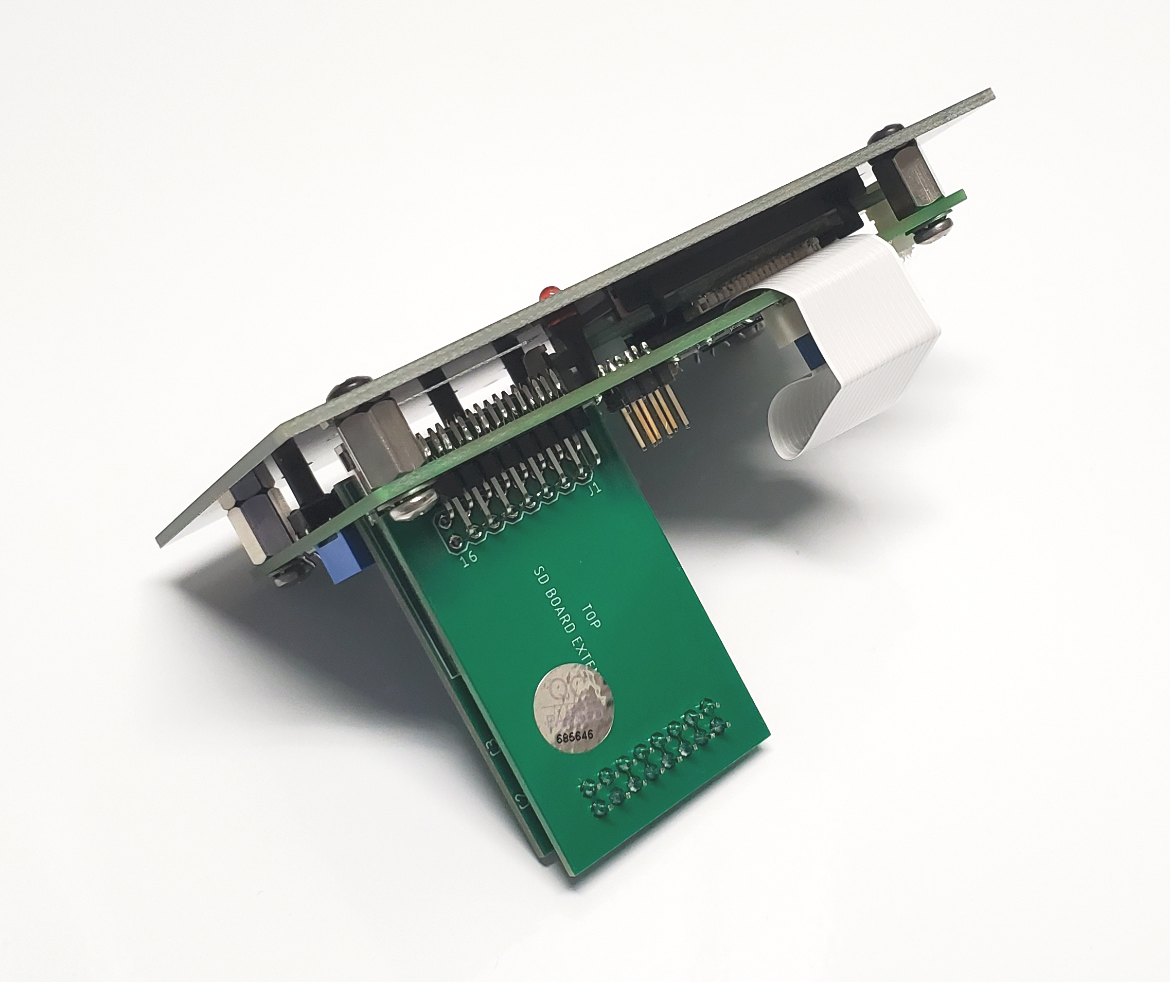

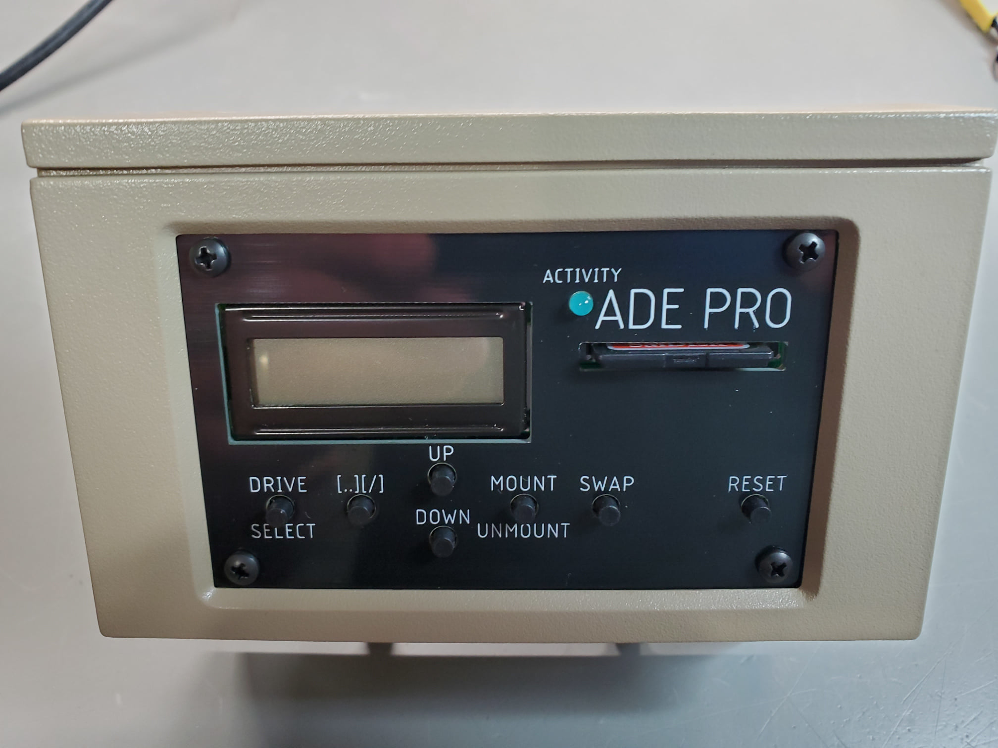

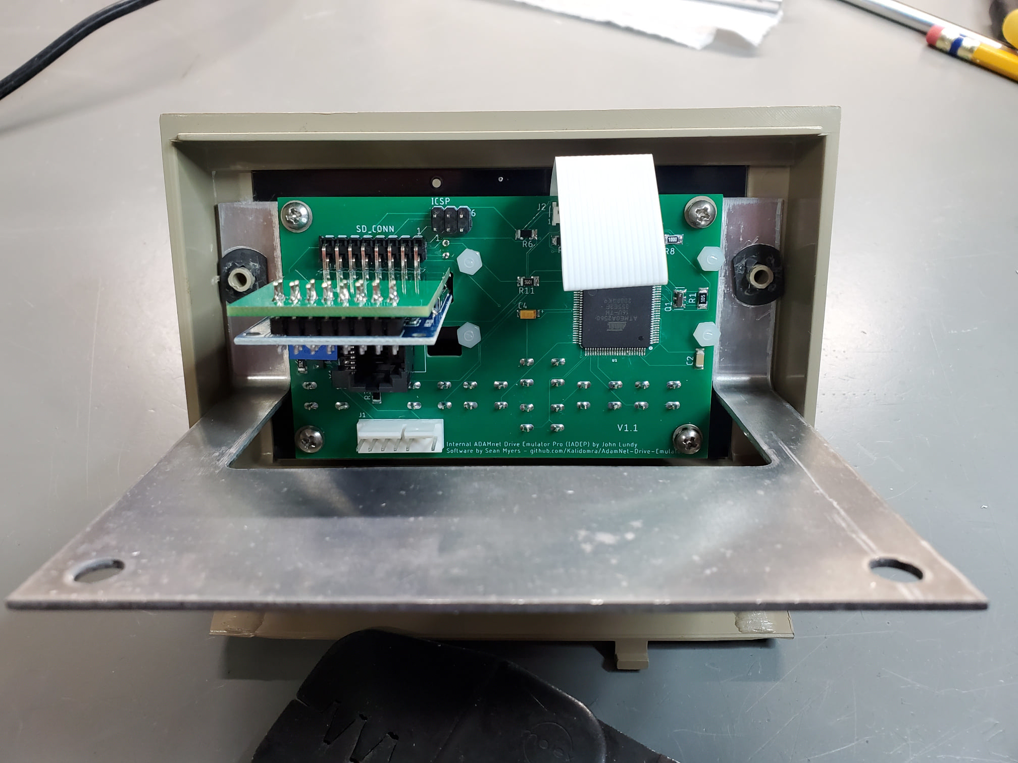

The Coleco ADAM Internal ADE Pro drive emulator combines features from the standard ADE, original ADE Pro, and ADE Lite all rolled into one unit. Front buttons include: DRIVE SELECT, [..][/], UP, DOWN, UN/MOUNT, SWAP, and RESET. Install the board set into a factory ADAM dummy drive (not supplied) and internally into one of the console’s DDP drive bays. It’s also a perfect companion to the SD DDP for a complete modern matching SD drive solution.

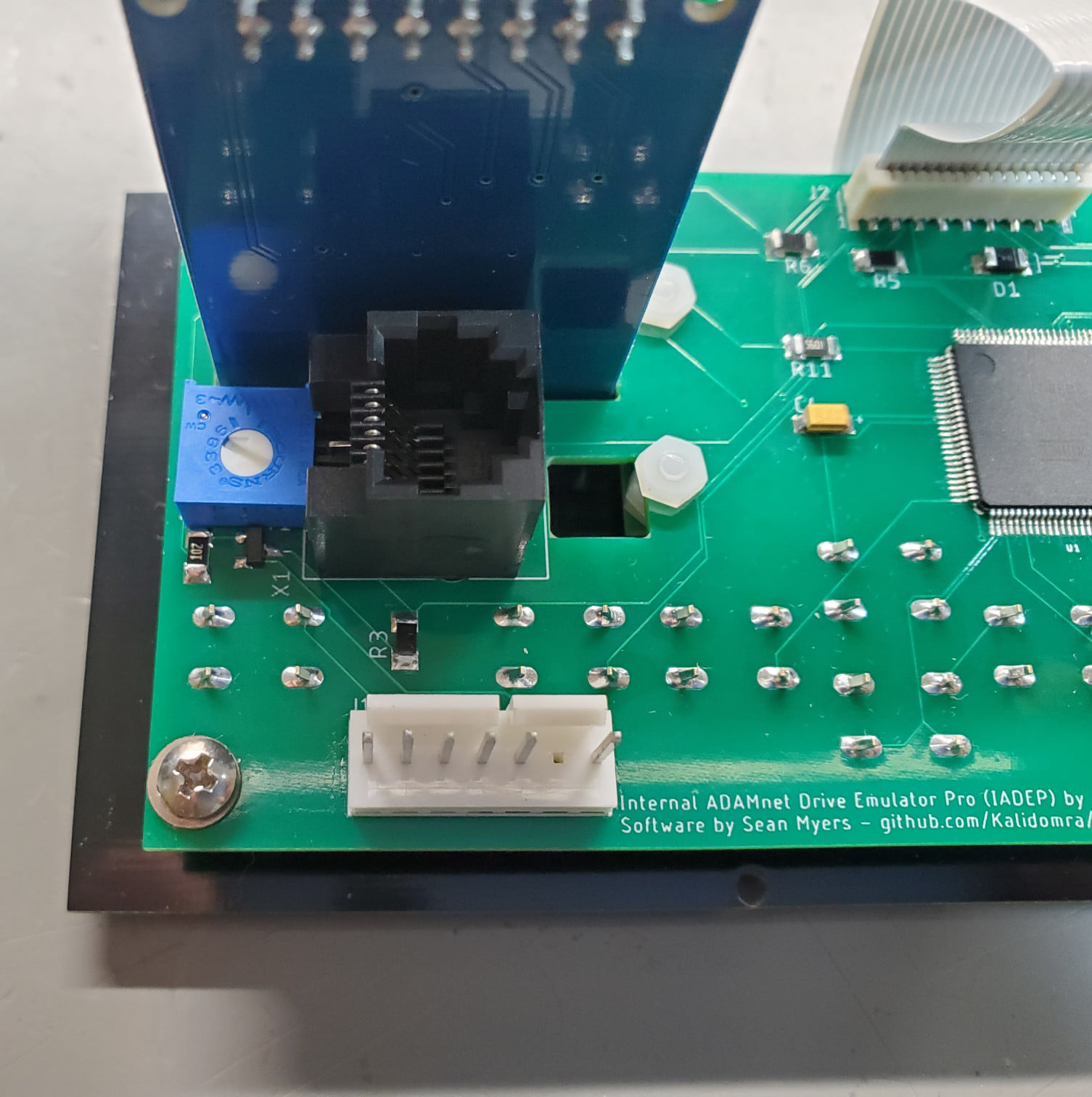

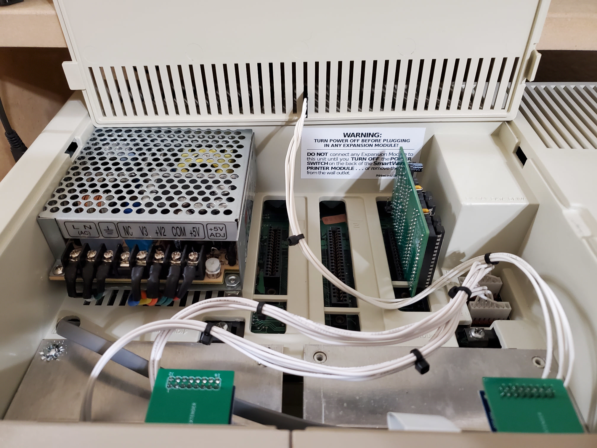

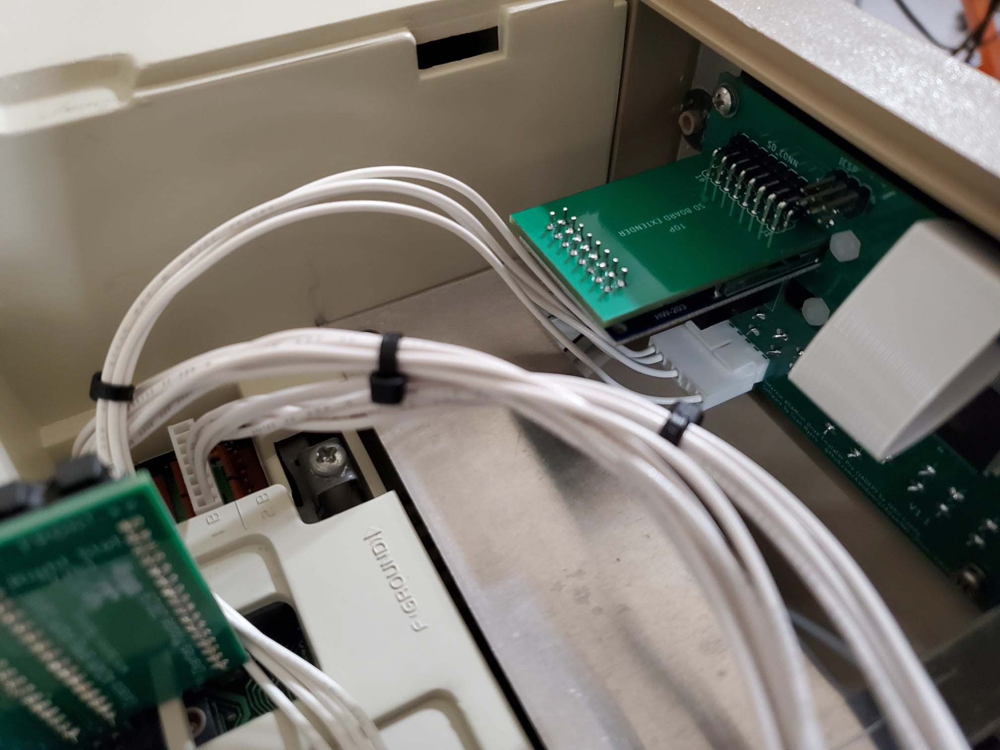

For seamless installation without running dedicated external ADAMnet wiring through the case top to the side ADAMnet port, you can use a Lundy Electronics exclusive ADAMnet Power Inlet Board. These boards offer a dedicated internal ADAMnet port inside the case to hide the necessary ADAMnet connection to your internal drive emulator. They also free up the console-side ADAMnet connector for other peripherals thereby avoiding the need for an ADAMnet splitter option to share the port with the drive emulator.
Lundy Electronics ADAMnet Power Inlet Board for External Power Supply Adapter (Factory printer or 3rd party external power supply): https://lundyelectronics.com/product/adamnet-power-inlet-board-for-external-power-supply
Lundy ADAMnet Power Inlet Board for Internal Power Supply Adapter (Internal power supply modified console): https://lundyelectronics.com/product/adamnet-power-inlet-board-for-internal-power-supply

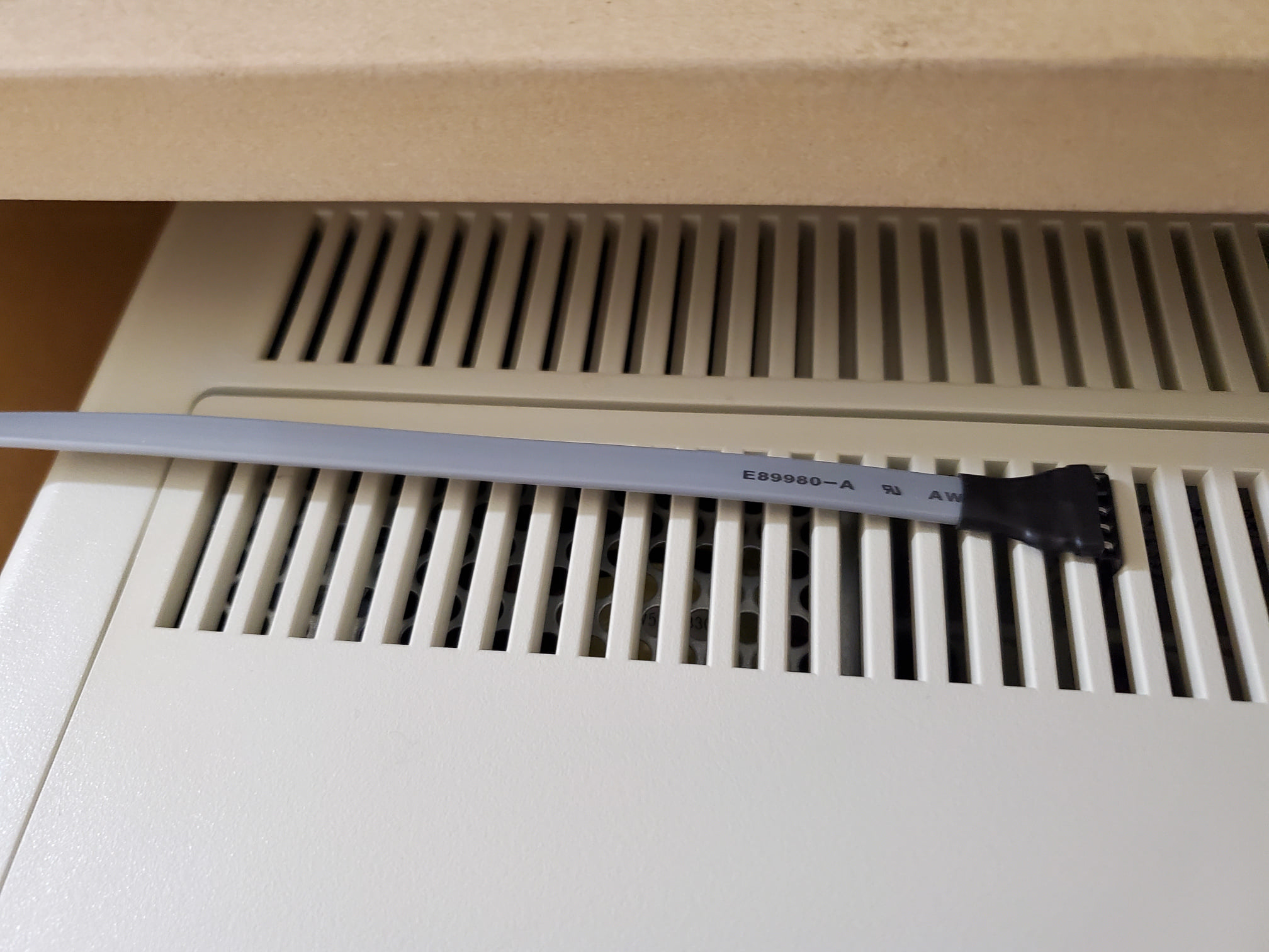

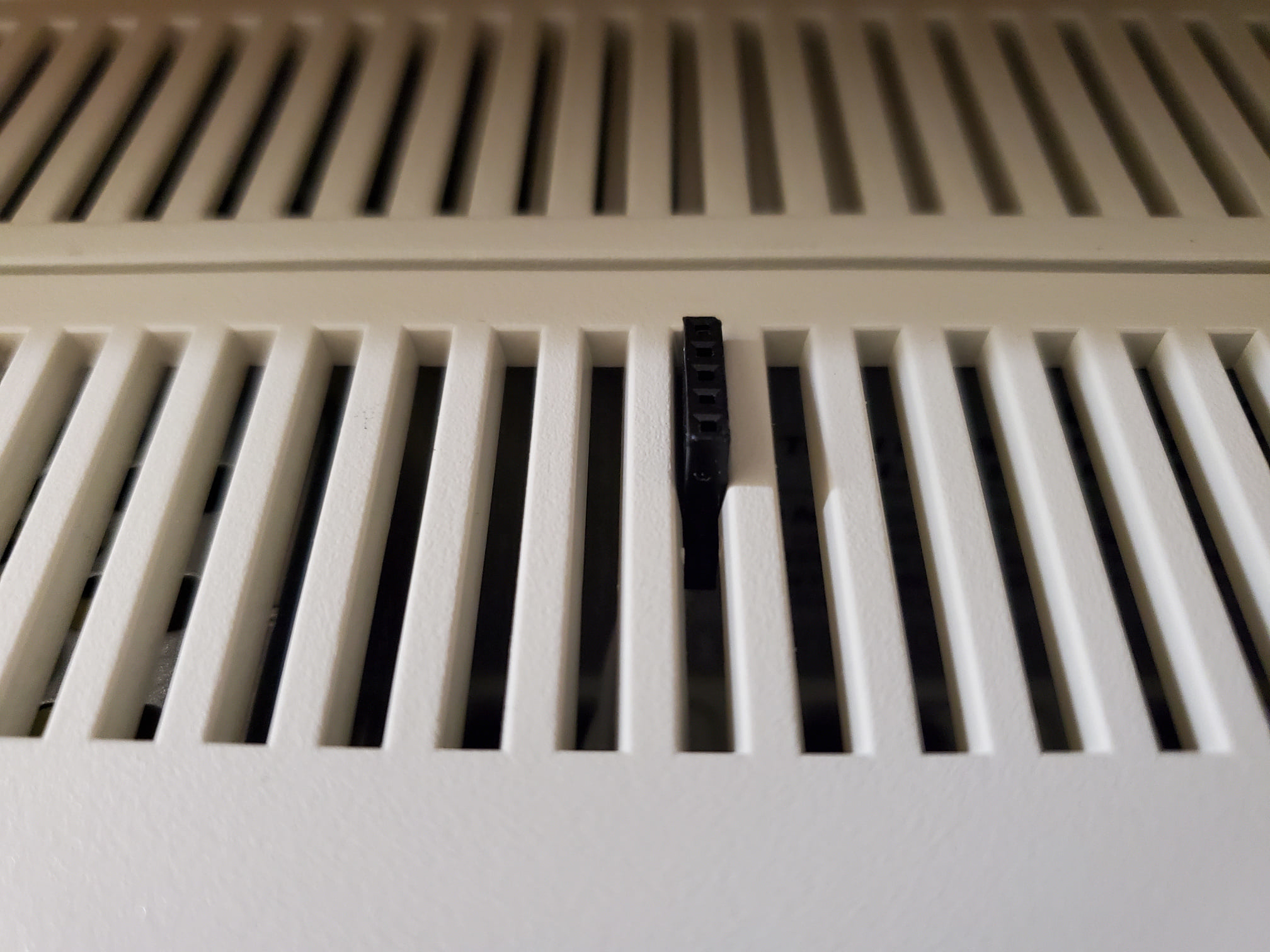

Connects with ADAMnet in two different ways. (1) Connect by traditional ADAMnet cable by tech savvy modders who have installed internal ADAMnet connections in their consoles. (2) Connect by the included ADAMnet pass-through cable kit that allows ADAMnet signals to pass through the case top vent holes from the side ADAMnet connector to the Internal ADE Pro special header connector on the PCB.

The optional 3D-printed dummy drive bracket is for use with the non-metal version of the existing mounting bracket. Two versions of dummy drive mounting brackets exist, one with metal and one with black plastic. The existing metal bracket version is the best choice when possible for ease of installation without modifications. If the black plastic version is present, it must be replaced with a 3D-printed bracket for mounting the board set. If you prefer to print your own, you’ll need to supply two #4-40 1/4″ machine screws and washers.
