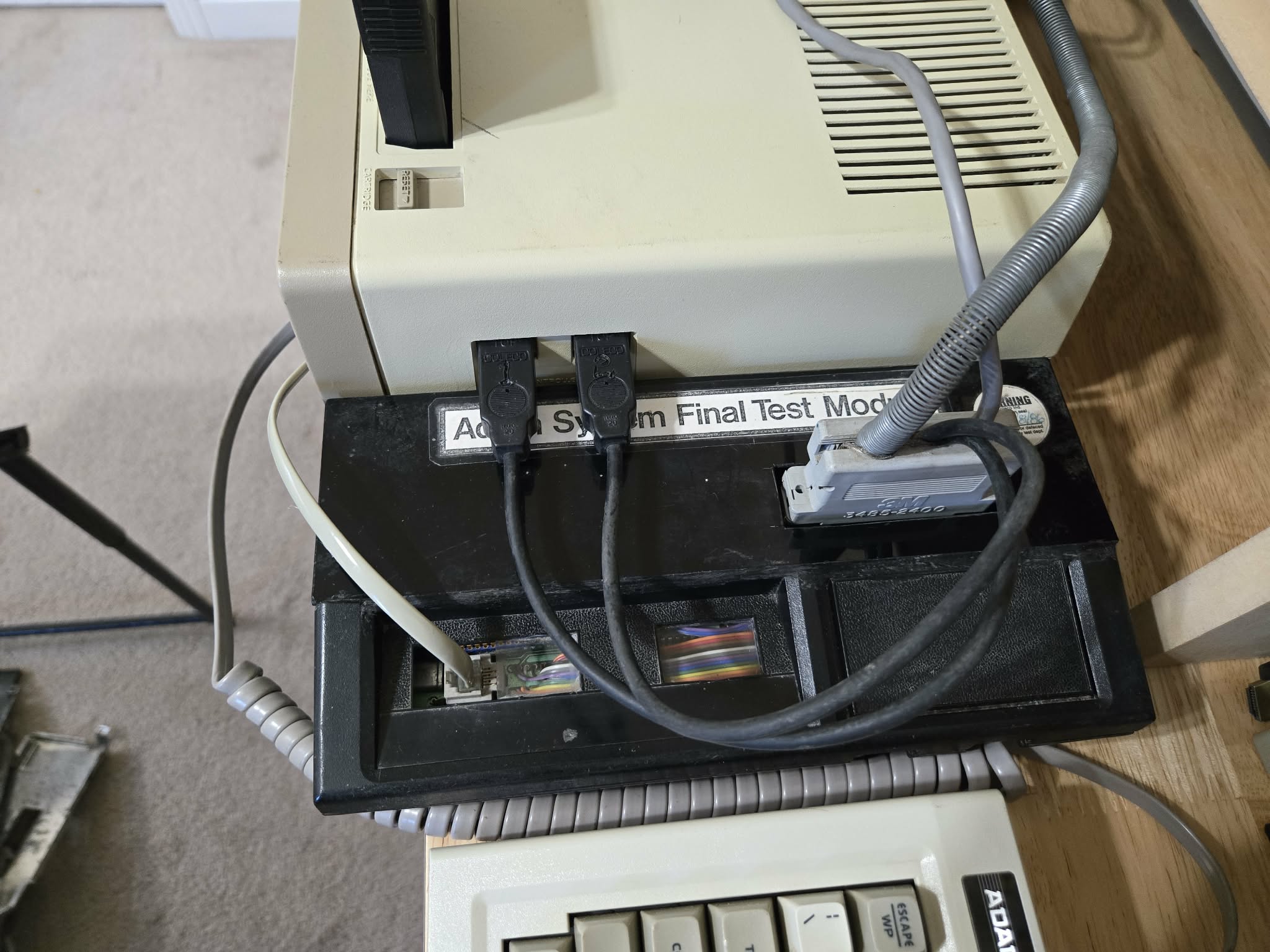

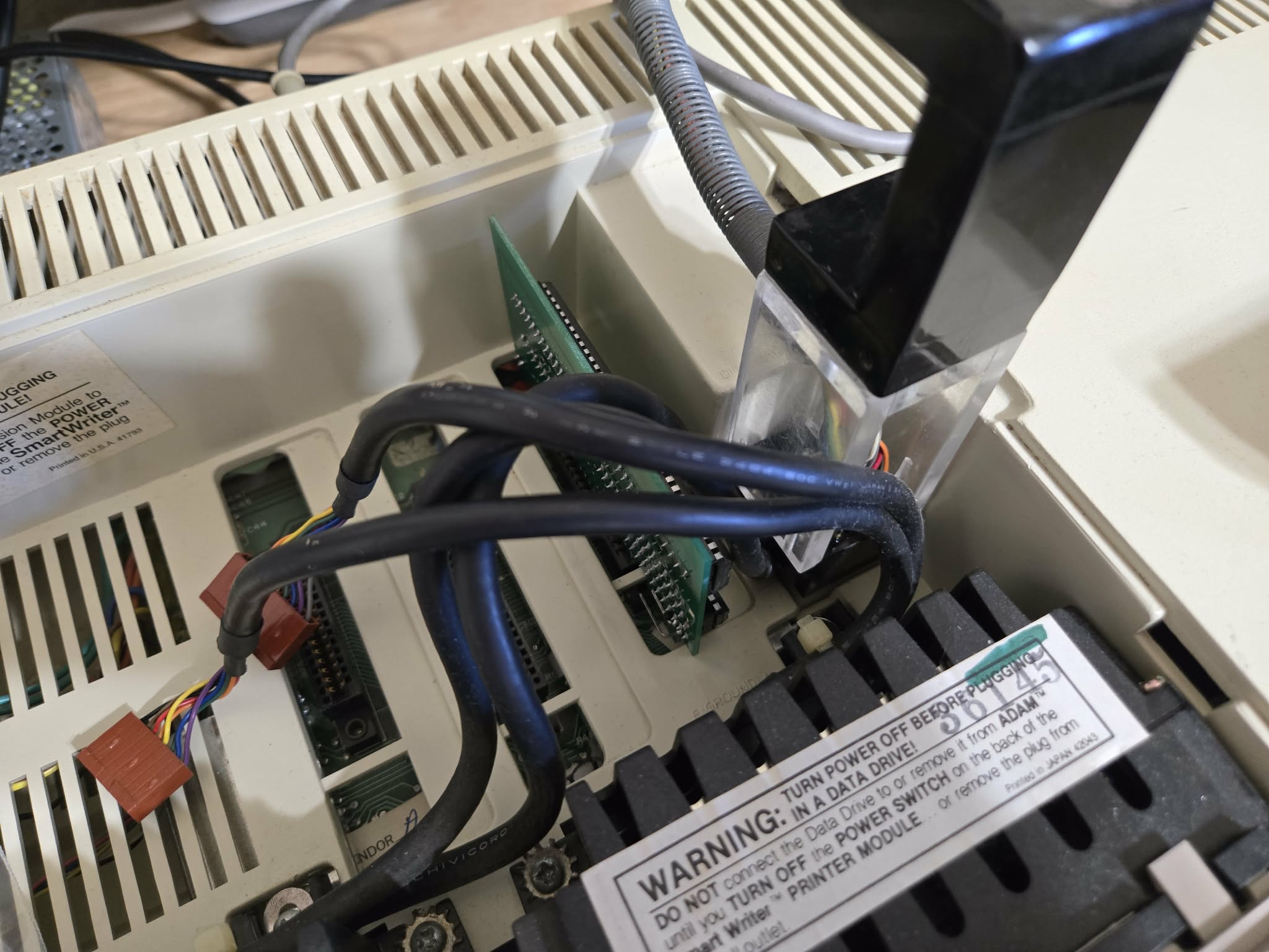

Posted: Sat Dec 06, 2025 11:11 pm
by RGDiRocco
What are your thoughts????

Looks like a fairly typical manufacturing text fixture. Apparently the funky connector gizmo is meant to plug into the data drive connections under the hood of the memory console. The DIN connector plugs where??? Hmm.

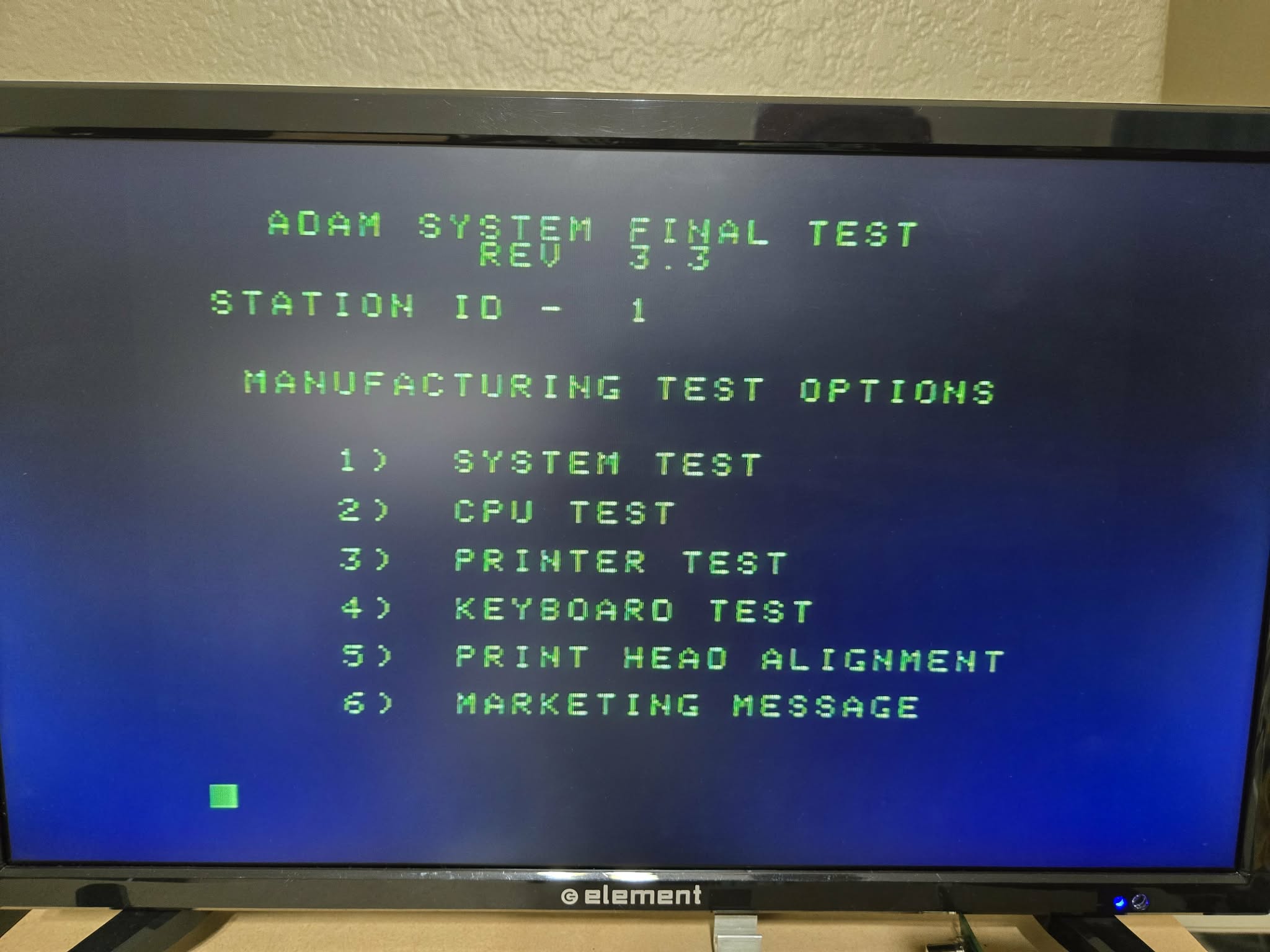

OPERATIONAL: ADAM System Final Test Module
Posted: Sun Jan 18, 2026 3:49 pm
by RGDiRocco

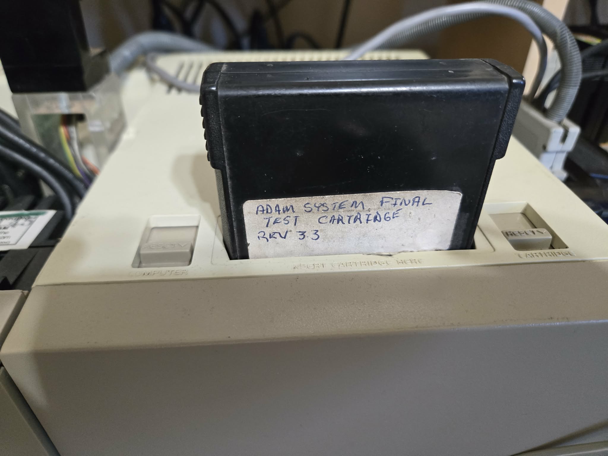

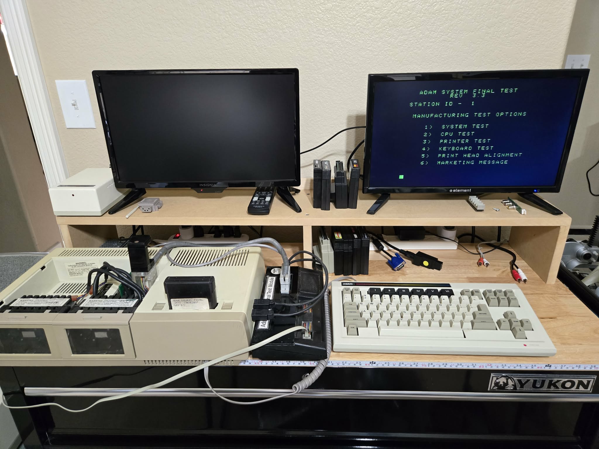

Its so cool to see this old school highly debated item finally be solved and tested. Thanks to the TEST LAB at Lundy Electronics, ADAM is being put through the setps and tested with the Module and its accessories.
We are looking for 2 special items if you can assist.
- ADAM System Final Test Cartridge 3.1 (we have 3.3)
- 8khz Track A & B Cassette
Enjoy the pics !!!!

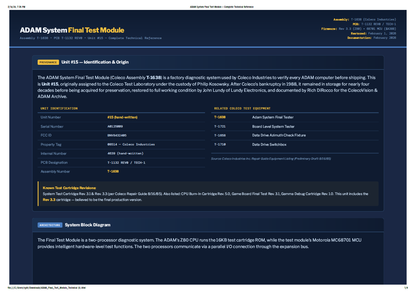

Its time to release the data and the firmware dump. Once again this would not have been possible without John of Lundy Electronics!!!
ADAM_Final_Test_Module_Documentation_v6.pdf
(3.39 MiB) Downloaded 52 times
Screenshot 2026-03-14 194544.png (213.27 KiB) Viewed 1119 times
Screenshot 2026-03-14 194609.png (131.22 KiB) Viewed 1119 times
