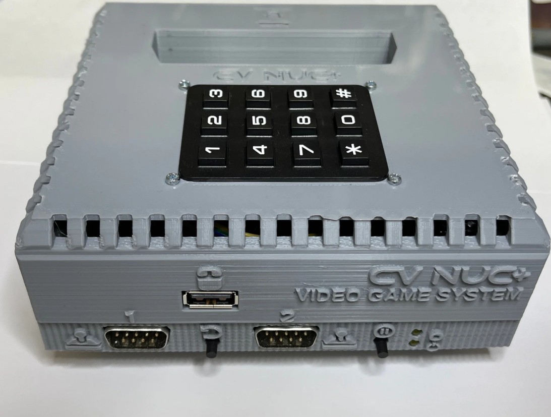

Optional integrated numeric keypad on case lid
Driven by PIC16F630 microcontroller
Allows use of Atari/Genesis controllers for games requiring keypad input
Two lid versions available: with keypad or without
